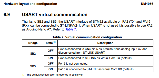

What board is this STM32 on?
If it's on an ST Nucleo, Discovery, or EVAL board - perhaps you have the same problem as this:
You would need to disconnect the STM32's UART Rx from the VCP before you can connect it to your ESP32.

The board is STM32-L432KC.
Can you tell how I can disconnect the VCP? Upon seeing the board manual, I only see like a VCP attached to TX.

@Abijith wrote:The board is STM32-L432KC.
That's the part number of the chip - not the board.
Did you mean NUCLEO-L432KC:
https://www.st.com/en/evaluation-tools/nucleo-l432kc.html
@Abijith wrote:Can you tell how I can disconnect the VCP? Upon seeing the board manual, I only see like a VCP attached to TX.
If in doubt, check with the schematics - they're on the 'CAD Resources' tab of the Product Page:
https://www.st.com/en/evaluation-tools/nucleo-l432kc.html#cad-resources
But this seems clear:
So you need to disconnect (at least) SB3

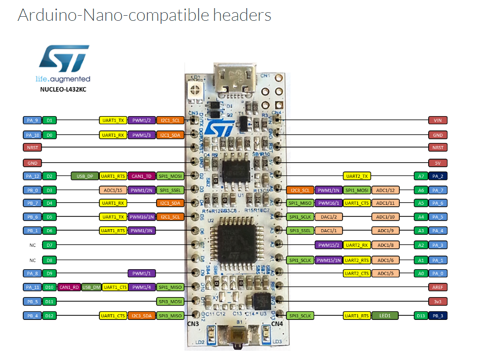

Yes, it's the nucleo 32 board. Also, by disconnect are you telling to remove the solder from the board?
Also, when I select the peripherals on STM32 Cube, it shows PA15 but on my L432KC itself there is no PA15. How do I interpret which is the RX and TX. TX is PA2 but the corresponding RX is PA3. Where does PA15 come in this picture?
2024-06-20 9:01 PM
PA15 is used for the VCP so it's not routed to the connector pins.
Don't mess with UART2 for the VCP. Use the VCP for debugging or to send data to the STM32 from Docklight
Just enable UART1 for PA9 and PA10 which are the first two pins on the CN3 connector. Connect those pins to the ESP's UART pins.

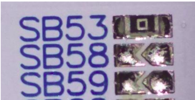

@Abijith wrote:by disconnect are you telling to remove the solder from the board?
Yes.
You remove the blob of solder to break the electrical connection - ie, to "disconnect".
This photo shows two solder bridges (SB58 & 59) which are "disconnected":

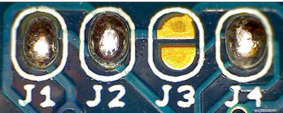

Here's another one - J1, J2, and J4 are connected; J3 is disconnected:
Image credit: https://www.pcblibraries.com/forum/footprint-for-solderable-jumper_topic2089.html
