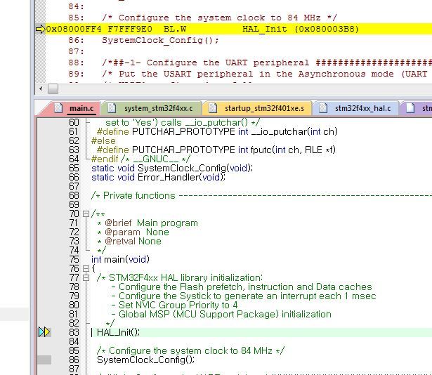

Hello STM32 users,
I've received the STM32F401RE board and am trying to run a test program on it. I downloaded uVision5 and the STM32Cube_FW_F4_V1.9.0 and opened the UART project that came with the package. The ''DM00107720-Getting Started with STM32CubeF4 firmware package'' document says I can just run it on uVision5. I don't know much about the ARM architecture let alone S TM32. I see COM16 port is seen on my PC but when I debug run the program, a yello and bright green arrow is pointing the first line of the main() program which is HAL_init(); as in the image below. I can press F10 to proceed but when I cross the printf statement, nothing comes up on my teraterm windows. (set to use COM16, 9600,odd,8,1 as the USART setting in the program). I guess I'm missing something very basic. What is wrong with my case? regards, Thanks,Chan2015-11-26 6:14 AM
It's really using ODD parity?
Keil would need retargeting code where the fputc() actually implements the output to the specific USART.2015-11-26 4:57 PM
Hi, clive1,
in the main.c file, it is defined as below. Isn't it correctly set already?#ifdef __GNUC__
/* With GCC/RAISONANCE, small printf (option LD Linker->Libraries->Small printf
set to 'Yes') calls __io_putchar() */
#define PUTCHAR_PROTOTYPE int __io_putchar(int ch)
#else
#define PUTCHAR_PROTOTYPE int fputc(int ch, FILE *f)
#endif /* __GNUC__ */
PUTCHAR_PROTOTYPE
/* Place your implementation of fputc here */
/* e.g. write a character to the EVAL_COM1 and Loop until the end of transmission */
HAL_UART_Transmit(&UartHandle, (uint8_t *)&ch, 1, 0xFFFF);
return ch;
Also, the USART is set as below (see odd parity).UartHandle.Instance = USARTx;
UartHandle.Init.BaudRate = 9600;
UartHandle.Init.WordLength = UART_WORDLENGTH_8B;
UartHandle.Init.StopBits = UART_STOPBITS_1;
UartHandle.Init.Parity = UART_PARITY_ODD;
UartHandle.Init.HwFlowCtl = UART_HWCONTROL_NONE;
UartHandle.Init.Mode = UART_MODE_TX_RX;
UartHandle.Init.OverSampling = UART_OVERSAMPLING_16;
