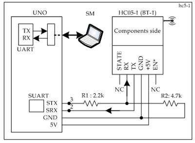

- I've even took off the voltage divider and it didn't work, It was added from the start like in this example :

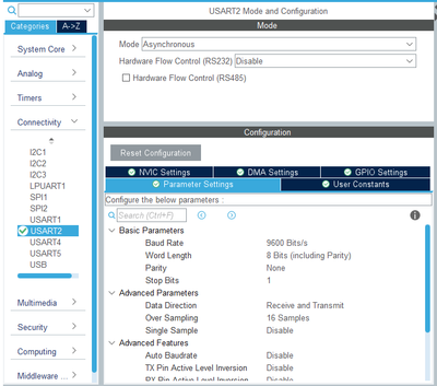

Here is the actual setting for the UART :
I think it is the same like you've described "9600 , 8N1 ;"

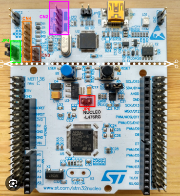

When I read it again I want to ask one more question. If I turn on USART2, and change it to work for peripherals and not for ST-Link, will my ST-link(OpenOCD) connection work without this PA2 and PA3 ? Because I don't understand if it will work without them why PA2 and PA3 are connected to ST-link.
As I understood when I turn on the USART2 the active pins are the ST Link pins (CN2) ? :
There are 4 pins but I guess when USART2 is on then 2 pins from those 4 are active and D1 and D0 aren't functioning as USART ? I don't know.
