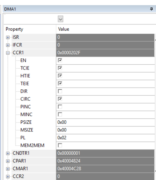

I'm facing a strange problem with UART DMA int in a FreeRTOS-based project. When I call the DMA setup function (below) from a given FreeRTOS task, it works just fine and the ISR is executed. However, when I call it from a different task, the DMA ISR is not executed at all. Although all DMA interrupts are enabled and the DMA channel itself is enabled.. ( I can see the registers in uVision debug mode). Below you can see register values. I don't know why the ISR is not executed. The DMA transfers only 2 bytes (instead of 10) and then stops. I double checked the DMA settings they are the same in both tasks../* Streaming DMA 1 (port-to-port) setup */
