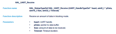

The blocking HAL_UART_Receive() API takes a timeout:
the non-blocking HAL_UART_Receive_IT() doesn't:
Using HAL_Delay() effectively makes your code blocking - so there seems no point in using the non-blocking API?

So after sending data , i run the blocking HAL_UART_Receive()with timeout of say 1 second and then check the HAL_StatusTypeDef return.
