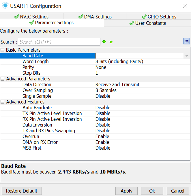

I try to send data via UART with a baudrate 8Mb/s using
Nucleo-L476RG and UM232H,
the programs I use are
STM32CubeMx and Putty (for RX)
As shown on the picture below we can send data
via
USART1
with a baudrate between 2.443Kbits/s and 10Mb/sbut in reality when I exceed 1Mb/s ,I don't recieve any information in RX,
Probably, it is a speed interval problem generated in code as shown on the pictures below, I think, there is a bad coordination between the configuration and the code,

2018-04-08 11:25 AM
So does it throw a HAL_ERROR?
If you take the USART BRR value what does that translate back to in terms of achieved baud rate?
Does the USART indicate Rx errors?
Please try not to create multiple threads for the USART topic
https://community.st.com/0D50X00009XkWUGSA3

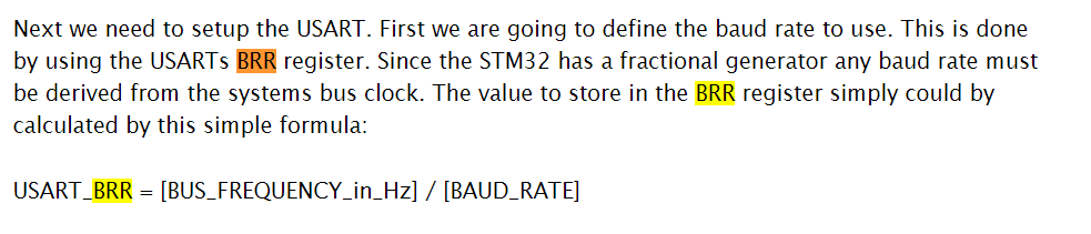

Hi, in fact, I solved a part of the problem, I used HSI instead of MSI, and with this solution I can reach 4Mb/s,
The problem now is that BRR is fixed all of the time at 16, Is there any solution for that, to obtain a maximum of baudrate!!
According to the expression below between BRR and Baudrate, we can obtain baudrate = 8000000/16 = 5Mb/s (Frequency fixed at 80MHz), but in reality we can reach only 4Mb/s and in this case I
looked at the signal with a scope and the baudrate was 4Mb/s, so is there a solution for these 2 problems :
1/ Why we can't exceed 4Mb/s! to reach logically 5Mb/s
2/ How we can explain the confusion, We have BRR = 16, and baudrate = 4Mb/s so that give frequency = 64MHz which is different to 80MHz we entred in configuration

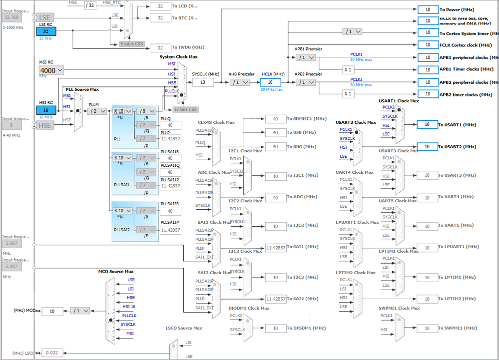

Hi, the problem is not solved, below is the clock configuration,
Based on the figure above,

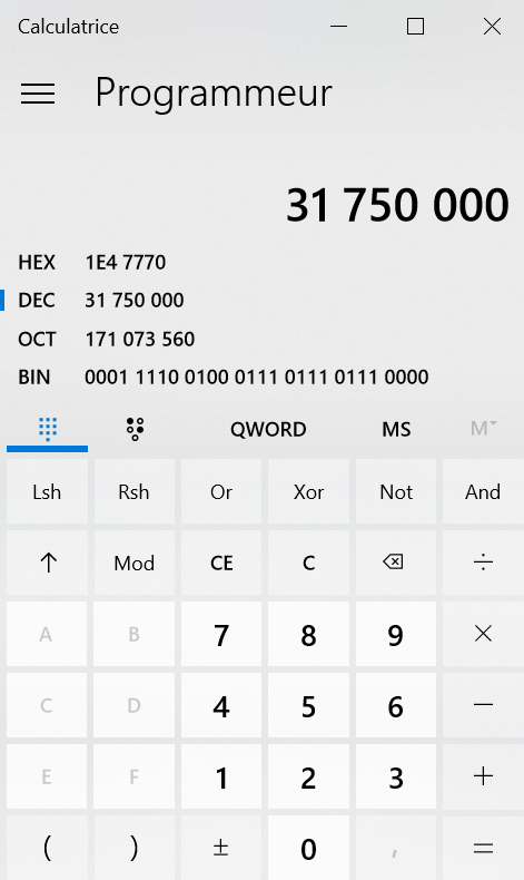

I tried to use the different divisions /1, /8.. and the different clk (PPLCK, SYCLK, HSE...) to obtain the correct frequency, but everytime, I have the some frequeny output that I showed on the scope,HSI --> 16MHZ (correct value)
SYSCLK --> 32MHZ (wrong value != 10 MHZ)
PLLCLK -->
I added some instructions on the code to show the frequency value, and that gives 32MHZ as shown on the pictures below
Anyone have a solution please!
