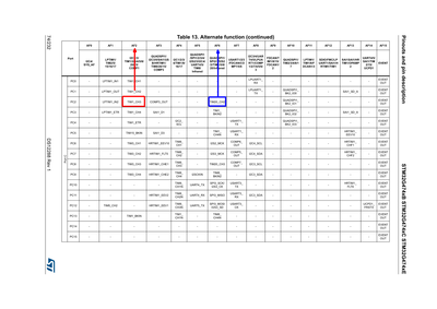

I have already checked that in advance.
My pin has TIM1_CH3 and TIM20_CH2. So that should be possible.

It's not GPIOx_MODER, that should be set to AlternativeFunction all the time.
It is GPIOx_AFR[] which you have to change.
Assuming you are talking about PC2
the field for that is in GPIOC_AFR[0], each field is 4 bits wide, so you can write:
// set PC2 to TIM1_CH3
GPIOC->AFR[0] =
(GPIOC->AFR[0] & ~(0b1111 << (2 * 4))) // first mask/clear this bitfield
| (2 << (2 * 4)) // and then set it to 2 for AF2 for TIM1_CH3
// set PC2 to TIM20_CH2
GPIOC->AFR[0] =
| (6 << (2 * 4)) // and then set it to 6 for AF6 for TIM20_CH2
