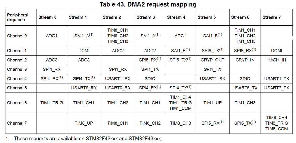

What is the content of TIM1_DIER in those two cases?
One step back: to which channel/stream did you set the two DMAs? JW2016-01-18 11:08 AM
I am using TIMER1
channel 1 (DMA2 stream 1)and channel 2 DMA2 stream 2)2016-01-18 11:42 AM
I am using TIMER1 channel 1 (DMA2 stream 1) and channel 2 DMA2 stream 2)
TIM1_CH1 -> DMA2 Stream 1 Channel 6TIM1_CH2 -> DMA2 Stream 2 Channel 62016-01-18 1:41 PM
Well, post the content of relevant registers of TIM1 (DIER, CCMR1, CCER) and DMA registers (registers of those two streams, plus the status register), then.
