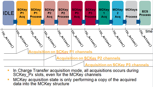

Each call to the TSL_Action() function forces TSL main state machine to jump to the next state. As shown below, the main state machine is composed of several states: SCKey P1 acquisition, SCKey P1 processing, ?
As it seems that you need to manage 8 touchkeys, both P1 and P2 banks will be required. This means that the complete process will require a minimum of 5 TSL_Action() calls (no debounce considered). To ensure safe system operation a debounce of minimum 1 should be specified. I would thus suggest you to call the TSL_Action at least every 10ms.

Let?s say that the acquisition time of a bank (P1 or P2) is 10ms. The total post-processing time (SCKey P1, SCKey P2 and ECS) will be less than 2ms. If we consider a debounce of 1, then the total process time will be around 45ms with a CPU load at 100% during this period.
