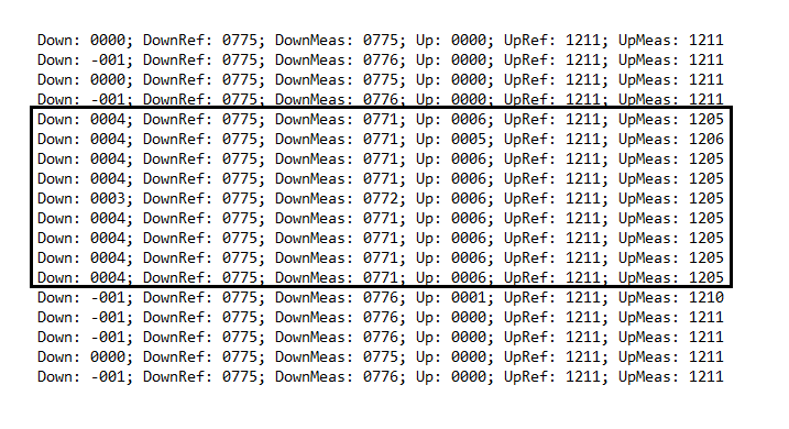

When there is no stop mode involved, the measurement delta of no pressing is normal (-1, 0, 1).
If MCU enters stop mode and then exits stop mode for touch sensing measurement, the delta would be much higher (6, 7).
However, the delta would become normal again in following situation.
The clock setting should be the same because program would call SystemClock_Config() after exiting stop mode.

Here is my test result:
The tricky part is that this would only happen after waking up from STOP mode. My program would make sure the touch measurement is completed before entering STOP mode.
2021-08-26 11:35 PM
John,
It looks like gpio parasitic capacitance is involved when we exit from STOP mode.
Usually Delta bellow 10 can be seen as noise (10% of Max value), Usual Delta value may reach 100..200.
To avoid this behavior I propose to set ECS and reset PROX. Doing this we will be able to adjust Ref on the fly.
