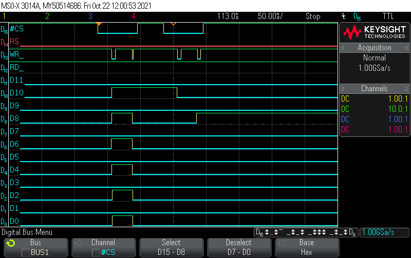

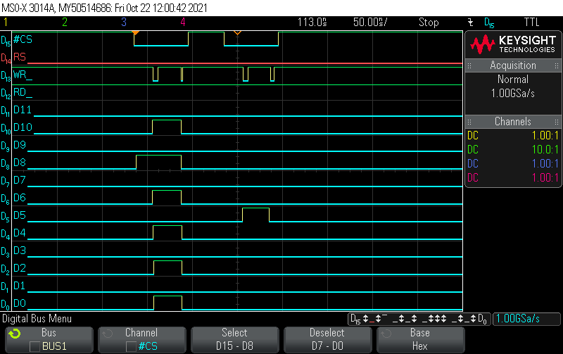

I'm trying to write to a single register of a LCD controller using the 16 Bit FMC peripheral in SRAM mode.
[update)
My assumption at the moment is that the controller writes 64 bits even the command STRH should only write a half word (16 bits).
When writing one single 16 bit word, the STM32H750VBT generates two #WR strobes within two #CS with alternating data in the second #CS sequence - for whatever reason I don't know. Reading from this address just works fine. One #RD, one #CS. I tried several options and timings, effect stays the same. CPU Cache is OFF. Has anyone an idea what I am doing wrong here? Thanks in advance!

0x2401'311c: 0xe7f6 B.N ??_writeReg_0 ; 0x2401'310cThe signals look like this:
is alternating with this
