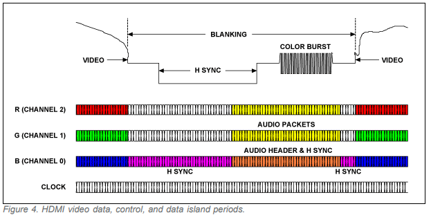

2022-05-13 12:45 PM
Looks to use 2 bit pattern stuffed in the blue channel, ie as part of the 8-to-10 bit conversion 2-bits get XOR'd into the pattern indicating the horizontal/vertical sync signals.
https://pdfserv.maximintegrated.com/en/an/AN4306.pdf
2022-05-13 2:07 PM
Yes! Your document gives us a better idea:
"The timing sequence of the analog video signals is exactly followed in the digital video signal format. In HDMI format, pixels are sent from left to right with horizontal synchronization codes between every line; lines are sent from top to bottom with vertical synchronization codes between every screen. During the times corresponding to the blanking of the analog video signal between every line and between every screen, horizontal and vertical synchronization pulses are encoded in channel 0. Four 10-bit code words, 1101010100, 0010101011, 0101010100, and 1010101011, represent (H = 0, V = 0), (H = 1, V = 0), (H = 0, V = 1), and (H = 1, V = 1), respectively. Using these codes, the horizontal and vertical synchronization pulses can be represented in the time domain with the accuracy of the pixel clock"

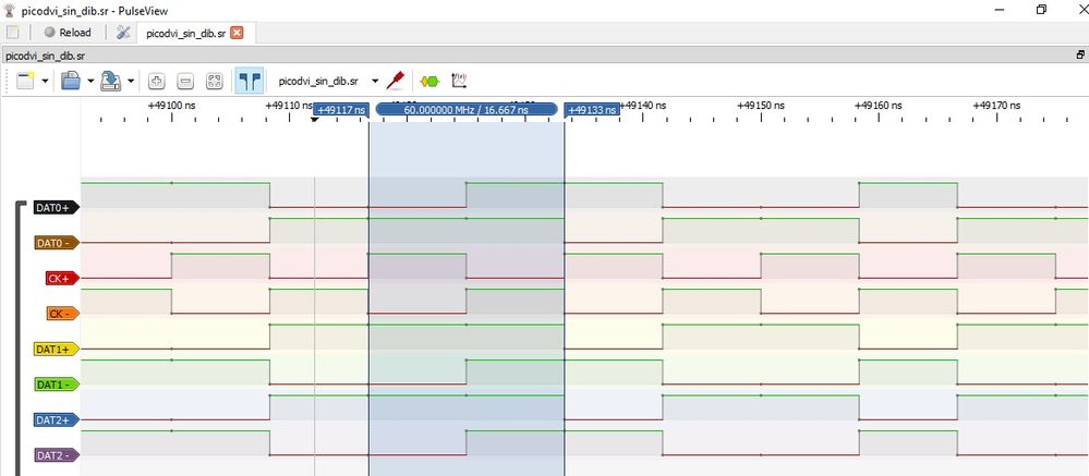

2022-05-25 11:10 AM
Here we have a better idea:
This was created via dvi 640x480@60hz with a pico that i have programed today, we can see, the signals are paired, in complementary mode.

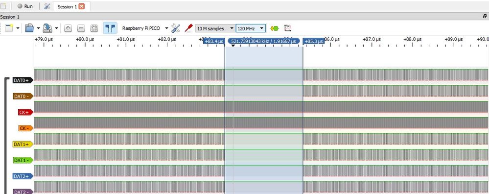

And here:
We can see, that ck´s signals, are consistent

P.D.: My LA only works at 120 Mhz, we can´t see the sync´s signals...
