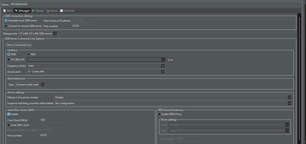

I then created a debug configuration using the following settings:
I then open the debugger and have a SWV ITM Data Console with port 0 enabled and have the trace started. When I run the code, nothing appears on the console.

Make sure the Core Clock reflects the speed you're running the part
Thanks. I checked the clock configuration page and used live expressions to view the speed.
I got 160mhz, then 96mhz(after it config'd I guess) from the live expressions.
Where exactly in the clock config page should I get my value from?
Thanks.
Isn't max 120 MHz? HSI running out of start, probably 16 MHz
