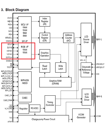

Check out the ILI9486 datasheet.

Hi primary you mix LTDC and displays... LTDC is internal name for display signal generator in STM32 = no display relevant... Learn how differ display bus types ...
Based on displays you can use then one or two or more type of bus with one used disply.
