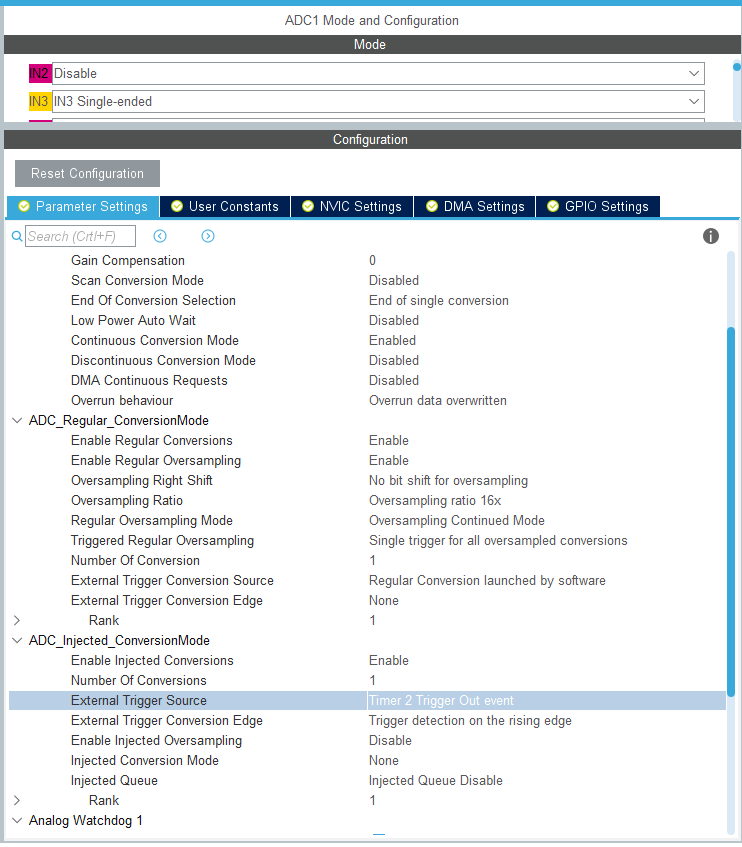

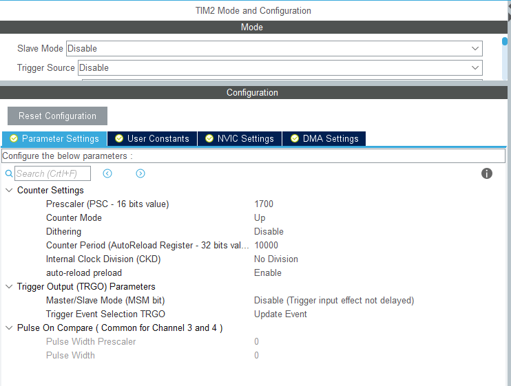

ADC1 running with "Continuous Conversion" mode, no DMA. It has one regular channel 3 and one injected channel Temperature Sensor. I want to use TIM2 TRGO to active the injected channel every few second. However, its not working.
When I set the ADC inject trigger source to software trigger, then call the function LL_ADC_INJ_StartConversion(ADC1); the ADC value of injected channel is updated aber correctly.
Then I try to debug TIM2 with interrupt, but TIM2_IRQHandler seems never be called.

ADC_INJ_InitStruct.TriggerSource = LL_ADC_INJ_TRIG_EXT_TIM2_TRGO;
ADC_INJ_InitStruct.SequencerLength = LL_ADC_INJ_SEQ_SCAN_DISABLE;
ADC_INJ_InitStruct.SequencerDiscont = LL_ADC_INJ_SEQ_DISCONT_DISABLE;
ADC_INJ_InitStruct.TrigAuto = LL_ADC_INJ_TRIG_INDEPENDENT;
LL_ADC_INJ_Init(ADC1, &ADC_INJ_InitStruct);
LL_ADC_INJ_SetQueueMode(ADC1, LL_ADC_INJ_QUEUE_DISABLE);
LL_ADC_SetOverSamplingScope(ADC1, LL_ADC_OVS_GRP_REGULAR_CONTINUED);
LL_ADC_INJ_SetTriggerEdge(ADC1, LL_ADC_INJ_TRIG_EXT_RISING);

void MX_TIM2_Init(void)
LL_TIM_InitTypeDef TIM_InitStruct = {0};
/* Peripheral clock enable */
LL_APB1_GRP1_EnableClock(LL_APB1_GRP1_PERIPH_TIM2);
/* TIM2 interrupt Init */
NVIC_SetPriority(TIM2_IRQn, NVIC_EncodePriority(NVIC_GetPriorityGrouping(),0, 0));
NVIC_EnableIRQ(TIM2_IRQn);
TIM_InitStruct.Prescaler = 1700;
TIM_InitStruct.CounterMode = LL_TIM_COUNTERMODE_UP;
TIM_InitStruct.Autoreload = 10000;
TIM_InitStruct.ClockDivision = LL_TIM_CLOCKDIVISION_DIV1;
LL_TIM_Init(TIM2, &TIM_InitStruct);
LL_TIM_EnableARRPreload(TIM2);
LL_TIM_SetClockSource(TIM2, LL_TIM_CLOCKSOURCE_INTERNAL);
LL_TIM_SetTriggerOutput(TIM2, LL_TIM_TRGO_UPDATE);
LL_TIM_EnableMasterSlaveMode(TIM2);
LL_TIM_EnableIT_TRIG(TIM2); //only for debug
LL_TIM_EnableCounter(TIM2);

2020-10-01 6:25 AM
enable temperature sensor first, it works
Then forget ADC and debug TIM2 first - read out and check/post content of its registers.
