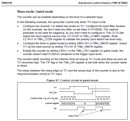

Hello!
You may use the slave controller in gated mode and to use a InputCapture channel for triggering.
Rgrds
