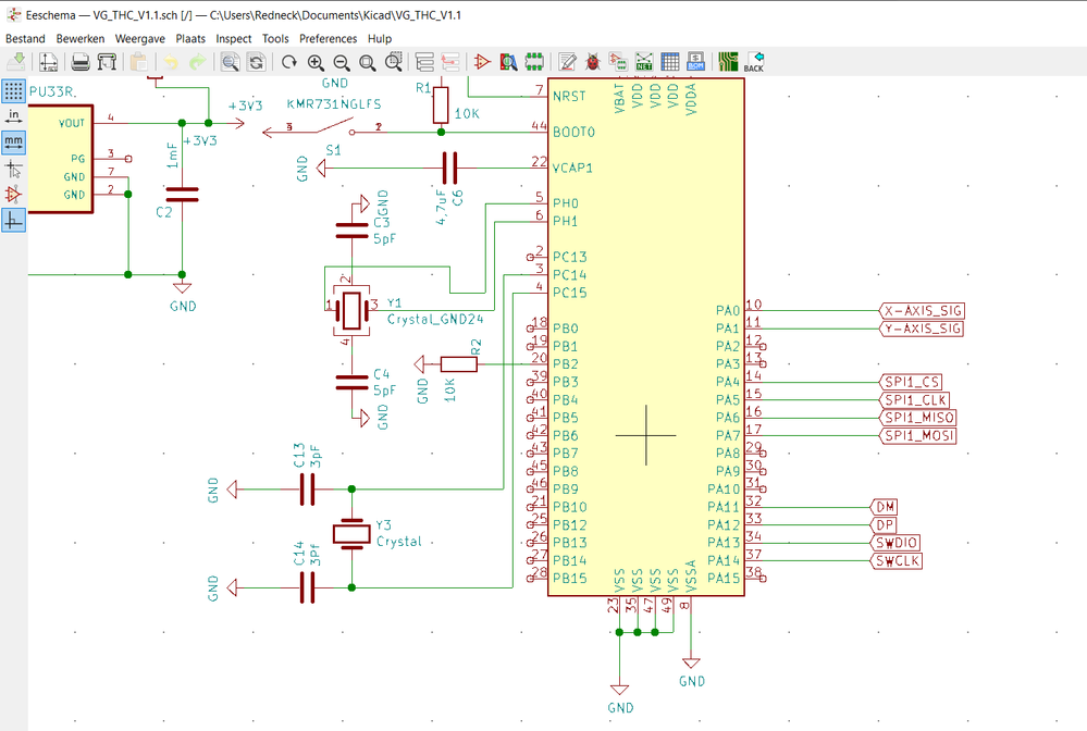

Recently if done a project regarding custom hid on a STM32F411RE Nucleo prototype board, this was successful. I have created my own pcb design but unfortunatly due the lack of availability of the STM32F411RE i was forced to go with the STM32F411CE QFN48. Adapted my board design and after populating my newly received boards i run into a snag. I adapted my original code to the 411CE alas its not popping up in my windows device list as a custom HID device. But it does show in DFU mode , i can upload my code through ST LINK. Debugger in CUBEIDE works fine. Just to keep it simple i made a bare project which only use the custom HID options out of CUBE IDE. Does behave exactly as described, but not showing up as Custom HID Device.
Might be a bit short sighted but i think it is not my PCB design,cause of the above behavior.
Maybe someone in here has some experience with the F411CE and can put me on the right track.

Just came to the conclusion the 4 pad crystal wasn't correctly placed, it was 180 rotated. I couldn't see where the pin 1 of the crystal was located so i just swapped it.
I made a quick Custom HID program and it worked.
After this correction my device works as designed. Thanks Tesla to pointing me to the clock.

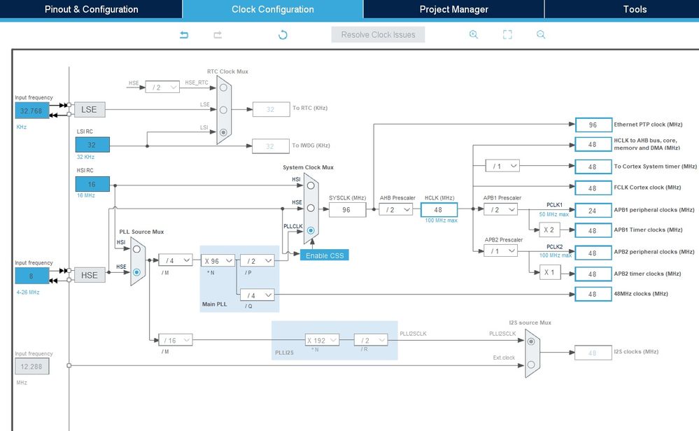

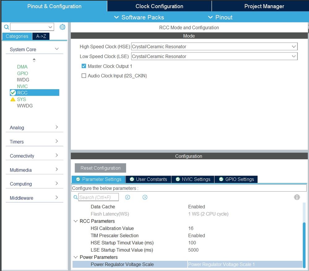

I have been Checking my HSE clock again on the RCC_MCO1 pin the output is 16.13 MHz , but USB custom HID needs 48 MHz. So something is of.
I configured the clock options through cube ide.
Been reading through datasheet of the F411 and some articles about crystals.
But to my knowledge i have done the setup right, maybe someone see an error
The code generated by cube ide below.
Hopefully someone could push me in the right direction.

My while loop doesn't run, so i suspect my oscillator isn't starting. My ADC does run but seems like ADC is not clock dependent.
Does the HAL layer work regarding clock settings?
If i select HSI i can measure the 16 MHz freq.
Certainly seems like it's using HSI and not HSE. Does Error_Handler get executed? Put something in there so calls do not silently fail.
What crystal are you using? 5pF seems low.
