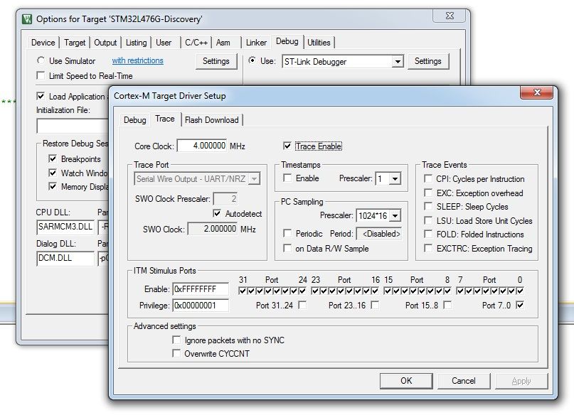

I am using uV5, I am using target options dialog to enable SWD and SWO. I am not mapping any pins for these functions nor changing any control registers related to them. Are there any registers I need to control using my code for SWO? For SWD, all I have done is used the target options dialog and board is working (single stepping, halting etc) as it should.

I cross-checked everything, i.e. clocks (all required clocks are enabled and set to correct values) and debug registers (checked if I am modifying their values but I am actually not even mentioning them anywhere in my code) . Ofcourse, after trying for last 3/4 days I have raised an ST ticket and waiting for their response.

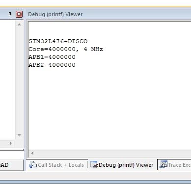

2018-06-05 7:21 AM
Forking the example project, making SB14, running 4 MHz

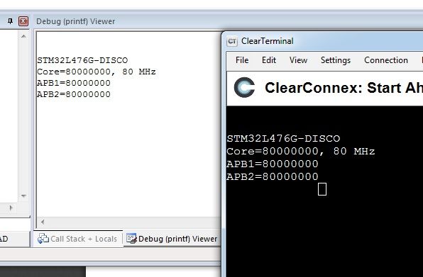

2018-06-05 8:36 AM
At 80 Mhz, and supporting the VCP via USART2 (PD5, PD6)

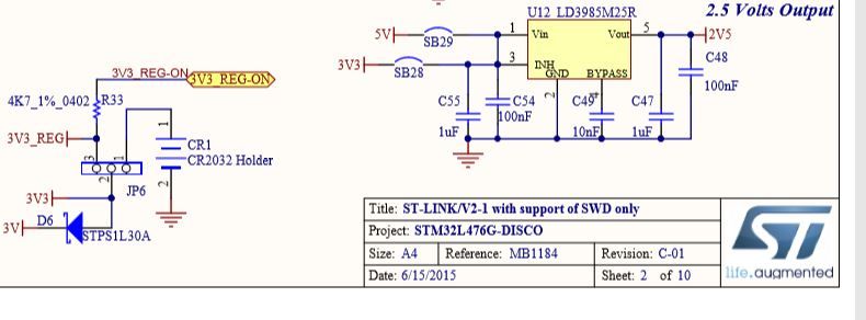

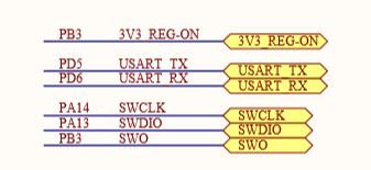

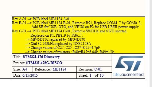

I reckon I have eventually found the issue, it's because the revision of the board you are using and the one I have are different.
Note the revision changes above. What's more peculiar is PB3 is connected (or can be connected) not only to SWO but it's already connected to 3V3_REG_ON as can be seen in the below images. This signal is connected to mutliple points in the board.
I tried changing the jumper JP6 from 3V3_REG_ON to CR1 battery but the problem is ST-Link is getting completely disconnected from STM32L4 Hence, all I can do is use it only for SWD. My quest ends here I guess.
If I am right, the more interesting question is why would ST guys do such a thing? Why can't they use any other pin other than PB3? Hope someone from ST would comment on this.
