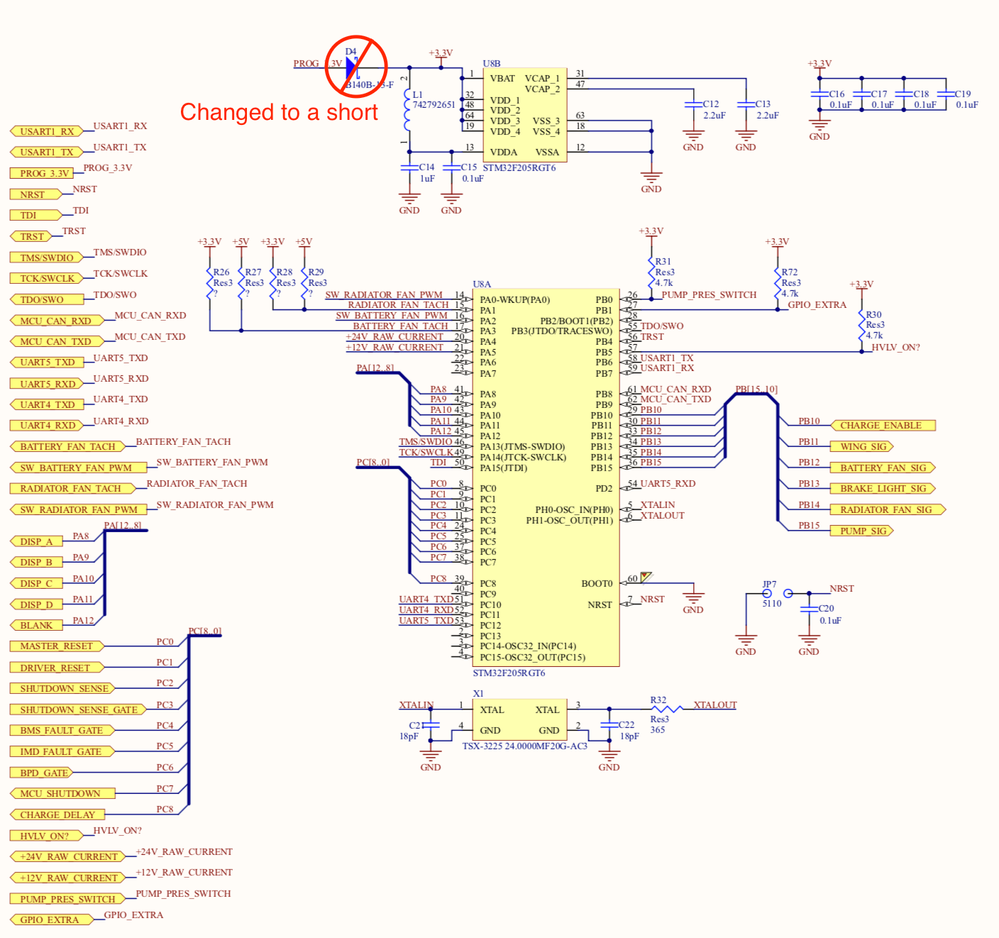

2018-02-08 11:15 PM
My name is Henry and I've been working with Jorge on this project - particularly on the hardware side. We are still trying to debug this problem and are taking a closer look at the hardware involved. Below is an image of the schematic of the MCU on our PCB which was procured by referencing schematics of dev-boards (primarily of the
http://www.st.com/en/evaluation-tools/stm3220g-eval.html
chip
) and by reading the data sheet of the . Please note that D4 is replaced by a short and we are using an external ST-LINK/V2-1 from a to program theSTM32F205
via SWD, so there is no embedded programmer. If there are any suggestions/errors in this schematic, pointers or advice are greatly appreciated.We’re moving the ST Community to a new platform to give you a better and more reliable community experience.
