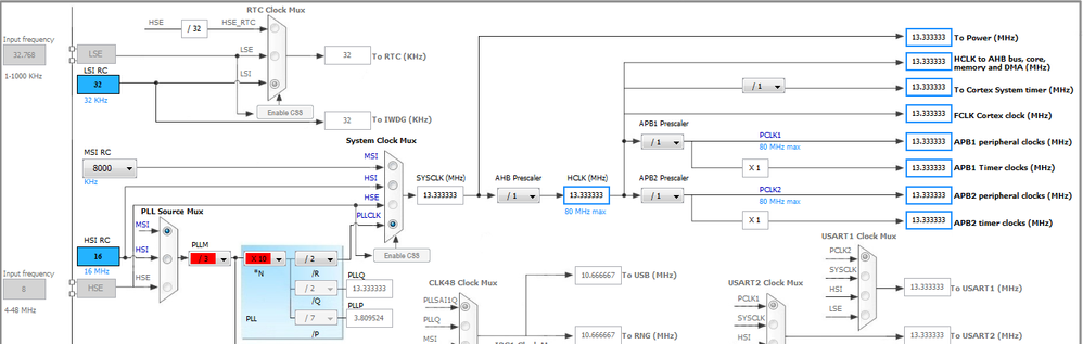

2017-05-19 4:04 AM
2017-05-22 8:09 AM
Here is your clock configuration. Strange !!!!
RCC_MSIRANGE_7 = 8MHz and PLLM dividor = 3. Which mean PLL input frequency is equal to 2.667MHz ?
It's not good to have PLL input frequency < 4. Range should be 4 to 16MHz (look into Datasheet > Electrical Charac > PLL)
With PLL config, SYSCLK = 13.333MHz
Not easy to have correct Timer interrupt with this settings !
I suggest you study the datasheet and reference manual before.
