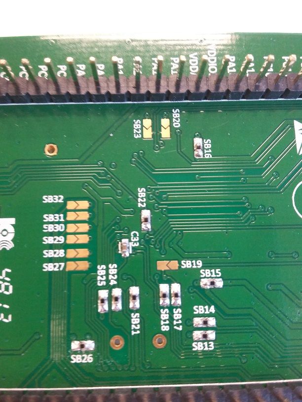

I am using an STM32F072B-DISCO. I am trying to get a PWM on pin A6 using timer 16. The timer seems to be counting as expected, but there is no output on A6.

Check SB29

Thanks Clive. The open SB29 was the problem. I need to pay closer attention to the schematics.
