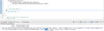

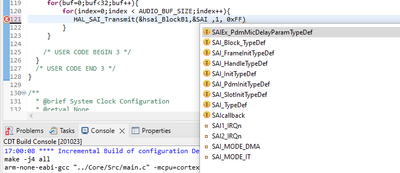

I tried to adapt the code to my microprocessor but I don't know which one to choose? In your opinion ?
After me the SAI (equivalent to I2S) work with 3 possible modes: IRQ, DMA and IT. Probably, I'll start with IRQ to make it as simple as possible.
I do this but I get a warning. Do you know how to call the SAI function to retrieve the values ?

Source of the ST library is available. Please read the documentation in the library files (.h and c) , it is helpful. The compiler warnings are very helpful - please read them and try to understand the reason.
2023-10-31 1:01 AM
Just to need the type and now It's correct.
