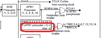

2013-03-15 2:12 AM
I can't understand why 3MHZ i think
/* PCLK1 = HCLK/16 */
RCC_PCLK1Config(RCC_HCLK_Div16);
generates 1.5MHz?
From the Clock Tree in the Reference Manual
2013-03-15 2:34 AM
Thanks
for your patience.
I forgot that
apb1
doubles the
clock
timers
. I will read again timer chapter, i think now it will be more easy. Thanks2013-03-15 3:06 AM
The description is a bit deceptive, it doesn't really double it, rather it takes a clock from further up the divider chain. So the operation isn't /16 then x2 but rather just /8
