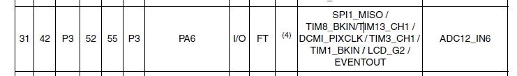

I would like to modify the init_timer() function in order to generate an interrupt every 100 expernal pulse in the pin PA6 with the TIM10.

#timer #interrupt #stm32f4292014-07-01 5:39 AM
However, with this change it doesn?t work!!!
Is there any flaw in my code?
The biggest one would seem to be your random association of PA6 with TIM10_CH1, you can't just make this stuff up, you have limited options as described in the Data Sheet/Manual.2014-08-07 6:30 AM
2014-08-07 9:30 AM
Pretty sure that TIM13 can't use an external clock source.
TIM3, a quick blind build// STM32F429I-DISCO TIM3 (CH1 PA6) External Count Demo - sourcer32@gmail.com
