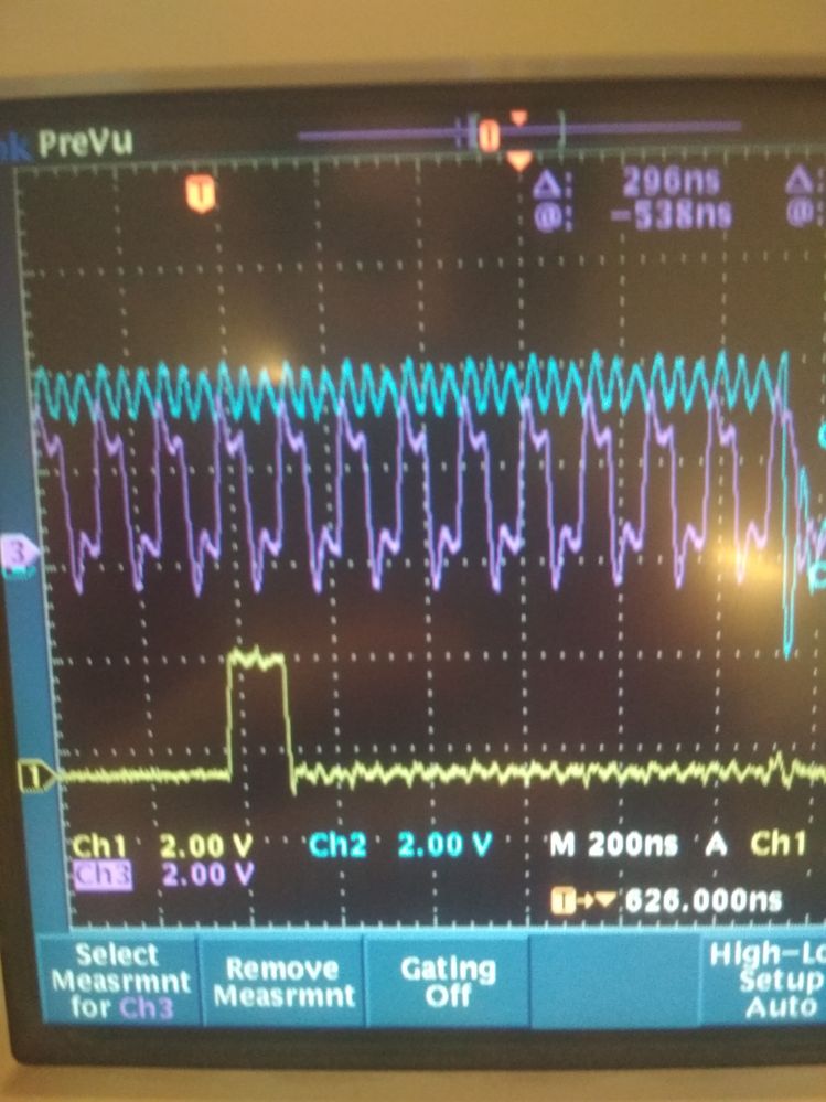

I want the falling edge of a reset signal to reset the counter, but it doesn't seem to happen.
This is what's currently happening, no matter what I do to sSlaveConfig.TriggerPolarity.( I can also see the values changing in the register)
So these are the signals in the image:
purple = clock
Yellow = reset
blue = output of timer
when the reset signal goes high, it seems to count the clock edge that goes high with it, then the following 9 rising edges after which it toggles the output.

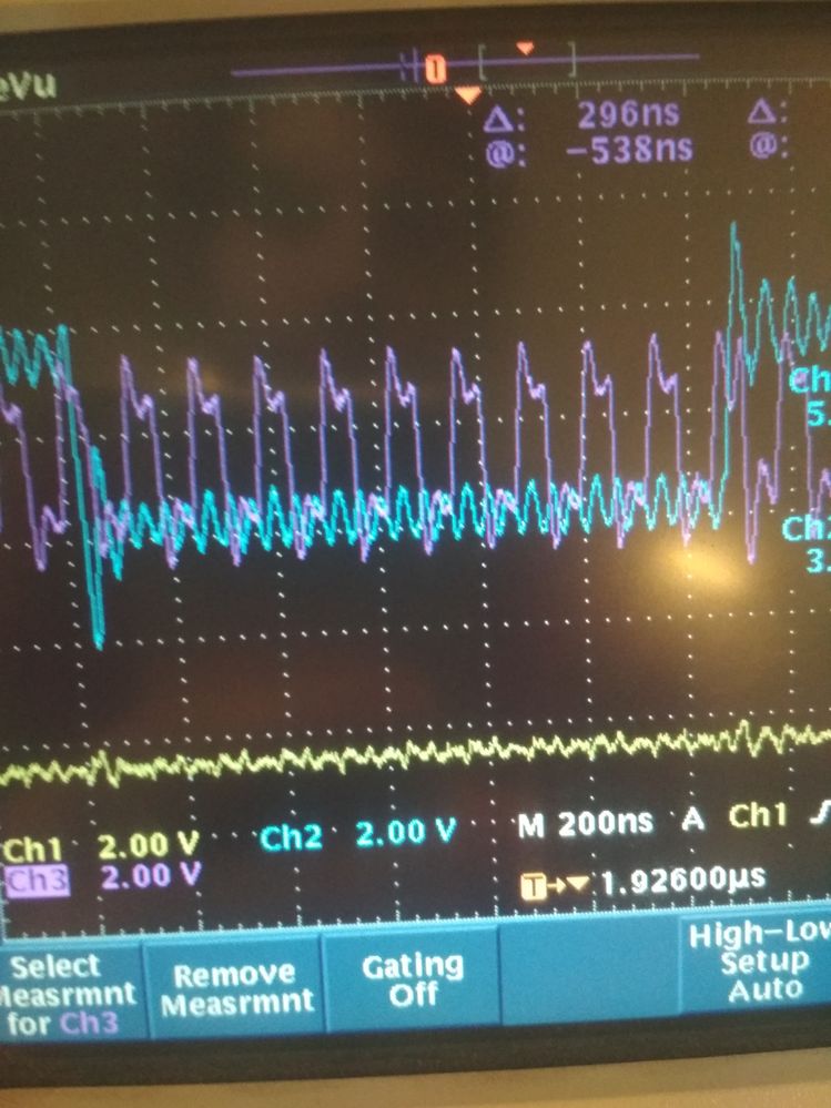

Here's one that occurs after the reset;
Here it toggles after 10 rising edges .

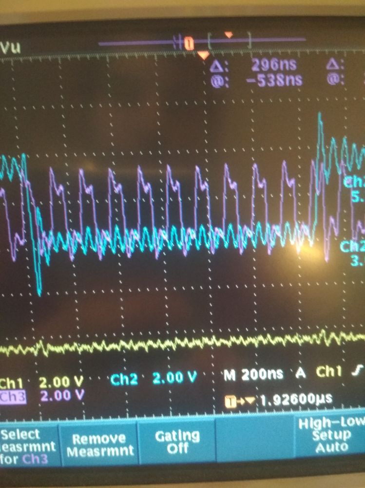

Here's another one:
How can I get the falling edge of the reset to trigger the reset, because I don't want the edge that rises with the reset signal to be counter?
