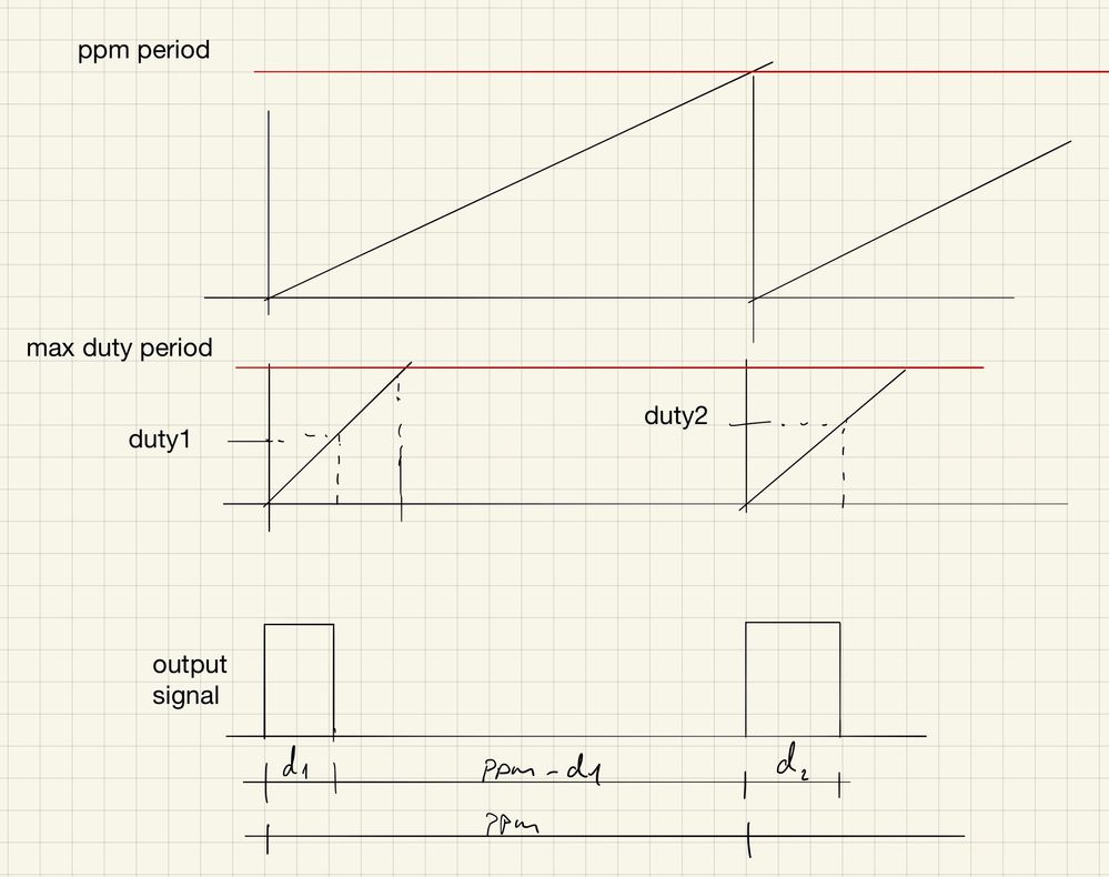

Can you draw a timing diagram to show exactly what do you want to achieve?

PPM period is like a carrier frequency. receiver is expecting to see raising edge every period for duty cycle duration. In the case of RC servo it is 20ms period and duty cycle duration if between around 1ms to 2ms. It could be little bit lower and higher limits, but mostly around those values.
Timing diagram attached.
