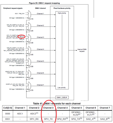

I am having trouble getting the Timer to trigger a DMA -> SPI operation. Namely, I want to set the timer up to run,. Then, get every overflow event to trigger the DMA to move a byte into the SPI. The SPI should auto-send. Then, the cycle repeats until the DMA has moved a N-bytes.
I am feeling really blind, because I cannot figure out the problem. At first, I was trying to find the right setting to get the Timer to trigger a DMA request upon UEV generation. However, I could not find such a feature. So instead, I setup DMA1 Channel 3. TIM6 should map to this DMA. Then I setup TIM6 to generate a UEV upon Overflow (URS = 1, UDIS = 0). Finally, I setup TIM6 to generate a DMA request upon update (UDE = 1).

So Channel 3 should be able to be triggered by TIM 6 and cause SPI1 TX to transmit...?

Are you sure that the transfers can do as I want? Thanks to you and Waclawek.jan, I am able to get the DMA to trigger, as caused by TIM6 UEV occurrence.
Will the DMA in circular buffer mode with N-bytes (CNDTR3 = N-bytes arbitrary number) move one byte per DMA request or N-bytes per DMA request?
