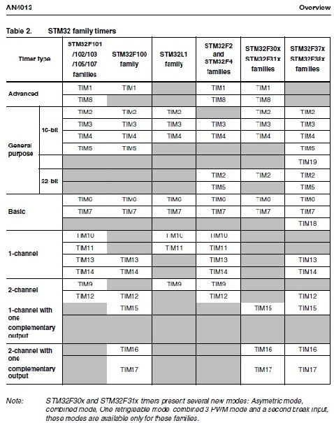

I was looking at application note:
AN4013
Application note
STM32F1xx, STM32F2xx, STM32F4xx, STM32L1xx,
STM32F30/31/37/38x timer overview
2013-11-16 8:12 AM

, see pg 29 (and others) You could verify the APB clock enable bits in the two registers, and confirm the TIM5 and TIM8 enable bits are stuck-at-zero. The VL parts should always be viewed as function stripped parts, the reference manuals tend to focus on the highest common denominator. I haven't review the App Note, but it appears to over state the functionality of the chip on the VL Discovery board2013-11-16 8:51 AM
Thank you clive1. I will refer to the data sheet as the definitive source to try confirm things like this in the future. I have run into similar situations in the past and there has been cases where the secondary documentation (application note) is actually right and the primary (data sheet) was wrong. But as you said, the evidence clearly shows the data sheet is correct in this scenario.
