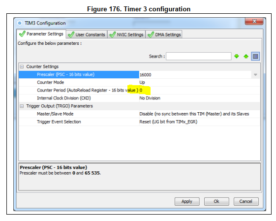

htim3.Init.Period = 0;
This means, the timer is not running (thus can't interrupt when rolls over, a.k.a. at Update Event).

Setting the counter period to a value other than 0 fixed the issue. Thank you.
However, look at Figure 176 in the UM1718 and it shows the counter value as zero.
