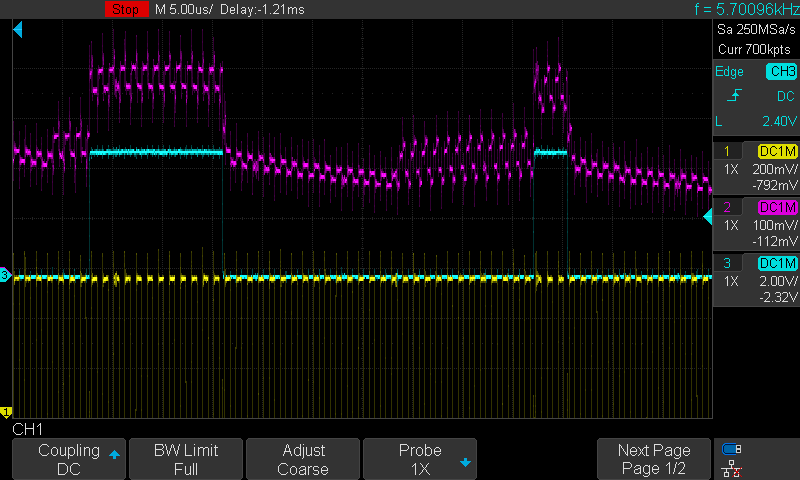

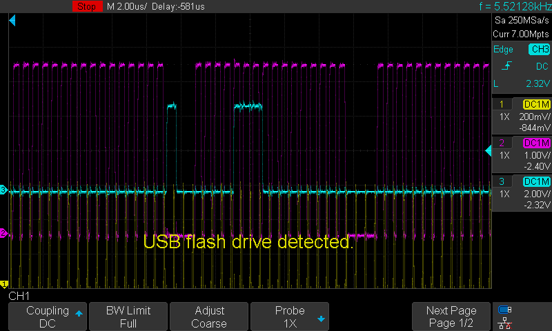

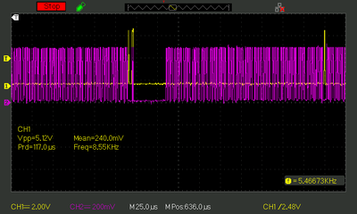

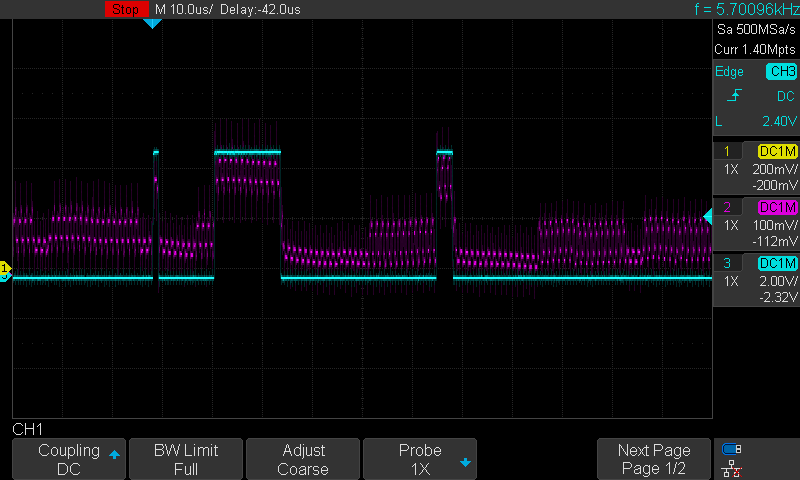

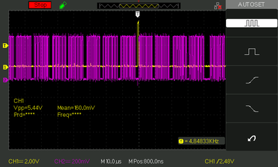

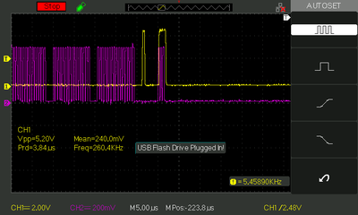

2025-07-31 8:08 AM
correct pulse1
out of sync
correct pulse2
2025-07-31 8:10 AM
i am inserting photos but it is not attacorrect pulse
correct pulse1
ching why?
