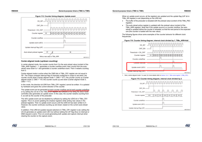

> update event occurs not only when the timer's counter reaches the auto-reload value (ARR), but also when it reaches zero
Yes, that's exactly according to documentation:
> How can I ensure that the update event occurs only at ARR in this mode?
You can't.
Try to use Compare instead, with setting given TIMx_CCRx to the same value as ARR.

As per the datasheet update event occurs when the timer's counter is overflow and underflow in centre align mode.
