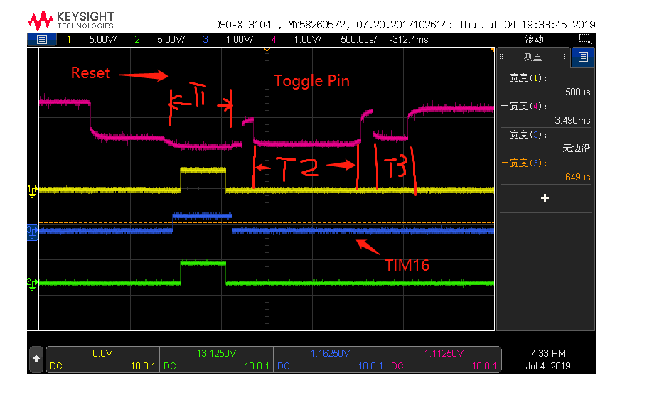

I have confirm below :
you can see my upload pic ,the left vertical yellow is time start point ,from top to bottom, four lines ,
so, TIM is running ,otherwise , can not generate interrupt three times.
If convenient for you, I send my source code to you .
