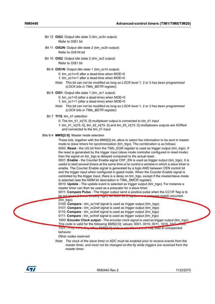

The difference between compare pulse (MMS==0b0011) and compare tim_oc*refc (0b0100 <= MMS <= 0b0111) is that
So I think that setting the channel to PWM mode 2 would solve your problem if the red remark at the bottom means that the slave is indeed triggered, but at CNT==0 instead of CNT==CCR

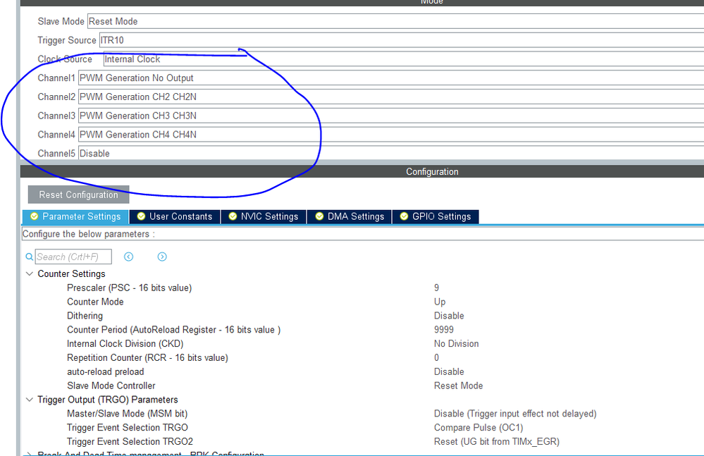

Maybe is the way I should configure in the STM32CubeIDE in the picture?

CubeMX settings mean nothing. Please post the contents of the timer registers.

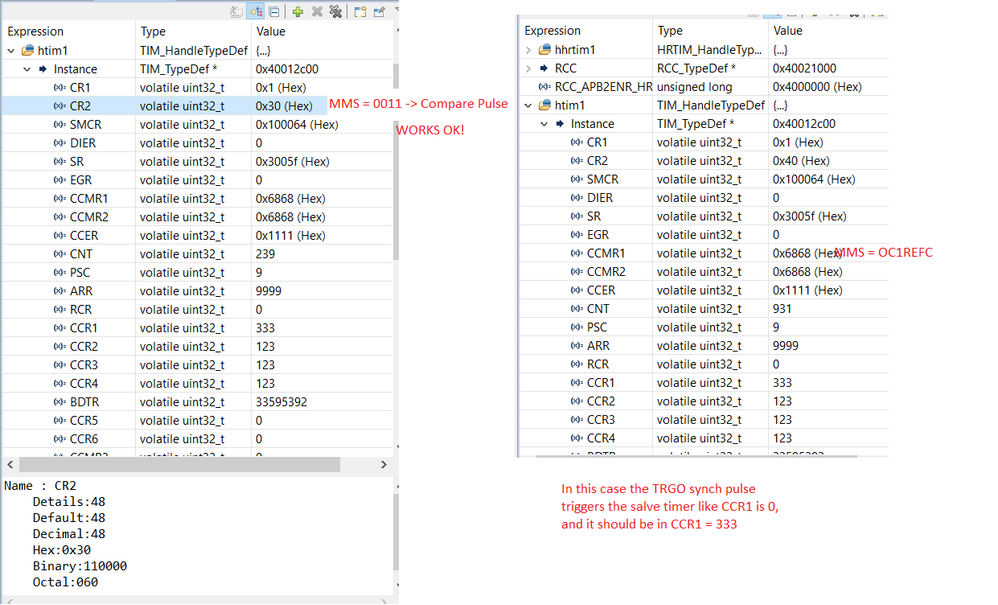

Hi Berendi,
Attached are two screenshots. At the left, TRGO is configured as OC1 and at the right OC1REFC. Just noted it ends in C, maybe is the complementary?
Anyways, it is strange that it doesn't act the same.
You can see also at the left and right that CCR1 is 333. In the left one (works ok) the trigger is at this value. In the right one, I see in the oscilloscope that the trigger is like CCR1 is 0, but is not.

Okay so in the first case, MMS=0b011 Compare Pulse, when compare happens, TRGO outputs a pulse lasting one timer clock.

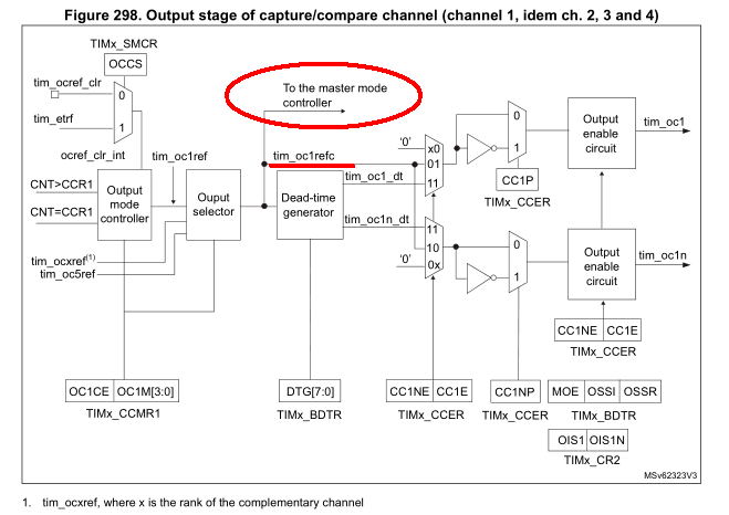

In the latter, MMS=0b100 so it's OC1REFC (I used an older version of RM0440 for the screenshot above, missing the "c" incorrectly). The C in OC1REFC comes from the fact that it's not OC1REF directly, but it's the result of combination with OC2REF, see description of combined/asymmetric modes in the description of OC1M in TIMx_CCMR1
As you don't have set any of the combined modes, in your case, the TRGO is then the same shape as the output you see on the pin, ie. "normal" PWM1 waveform.
Now why this does not do what you expect in triggering the slave, might depend on the particular setting of the slave, and in the particular sequencing of events.
