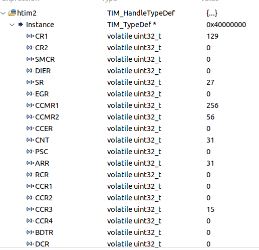

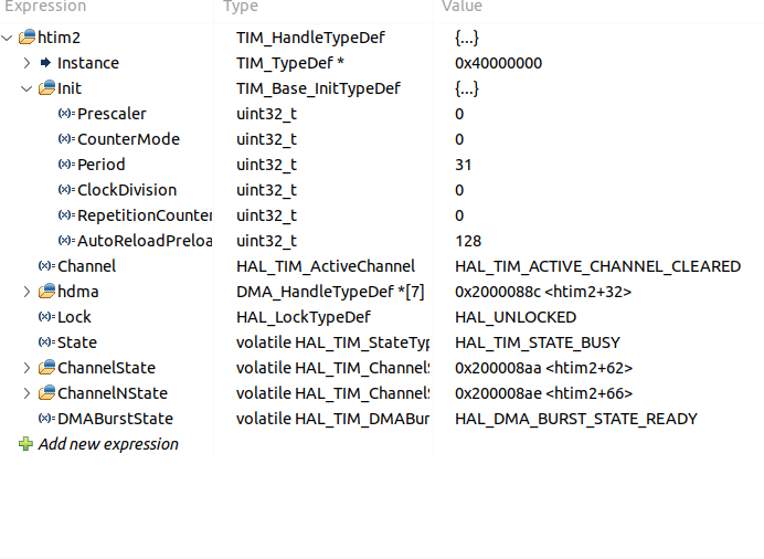

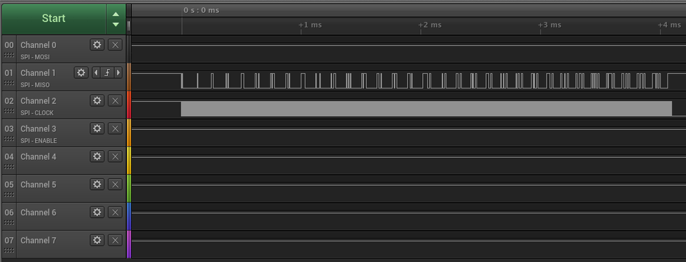

2023-06-01 6:29 AM - edited 2023-11-20 4:15 AM
Hello Jan,
TIM2:
And then:
The Logic Analyser (you can see the SPI) and, the orange trace is "PB10" (stays high)
And the .ioc is included in the original question.
2023-06-01 6:58 AM
Have you had a look at those registers yourself, checking their content against the description in RM?
