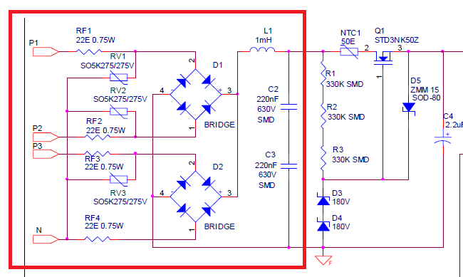

Page 8 of this app note: ( https://www.st.com/resource/en/application_note/cd00074286-threephase-smps-for-low-power-applications-with-viper12a-stmicroelectronics.pdf )
has this image.
The red box i understand, can make AC-to-DC till here.
After that have to convert this pulsating dc to 5V/0.470A without transformer.

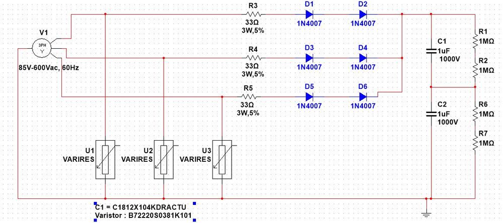

Hi peter,
This is how i plan to convert three phase(with neutral) to dc . Simulated only yet, to be tested

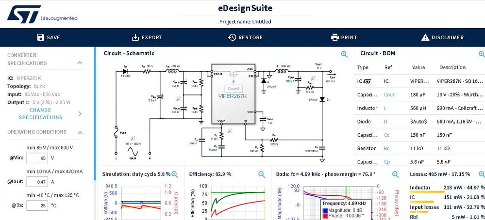

After that I used e-dessign suite with:
1 Vin: 85V-600Vac
2.Out: 5Vdc/0.47A
it makes this circuit, but some of its compnents are very non standard, is there option to select standard parts?
Also output will be 5V/0,47A , how much tolerance in current and voltage we have to expect here?

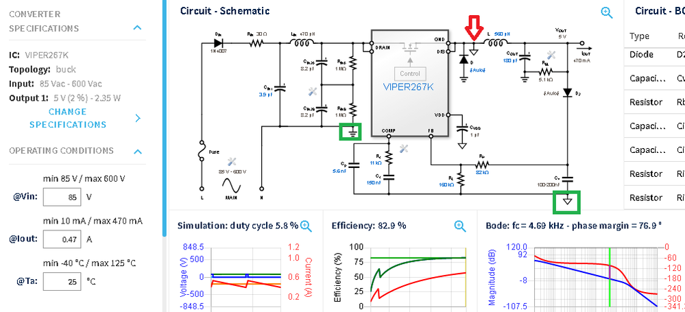

A) I have put these specs in e-desgin suite:
Vin: 85V-600Vac
Vout: 5V/470mA
It geneartes below diagram: But I have below queries
B) The arrow sign marked in red, how is digital low power ground connected here? How will i et 5V at the output then?
C) Also do high power ground and low power ground need to be shorted (marked by green box) . Datasheet of VIPER26K says it should.?
2020-09-28 8:08 AM
Let me first answer your last question: the red arrow points to a triangle, which is some kind of a GND seen by the VIPer267K only (!). It is not the GND for your 5V output voltage!
Please connect the load parallel to Cout, i.e. at Vout (5V) and the neutral line N (your left green box)
The VIPer26K in this mode works floating. Maybe it gets more clear with the same schematics shown in fig. 29 of the datasheet.
To your questions before:
Which of the components you'd like to modify?
Tolerance: It is difficult to specify a value for such a buck controller, as it also depends on the behavior of the load. Usually behind this is a linear regulator with a suitable PSRR value at the specified switching frequency in order to smooth the output voltage.
Regards
/Peter
