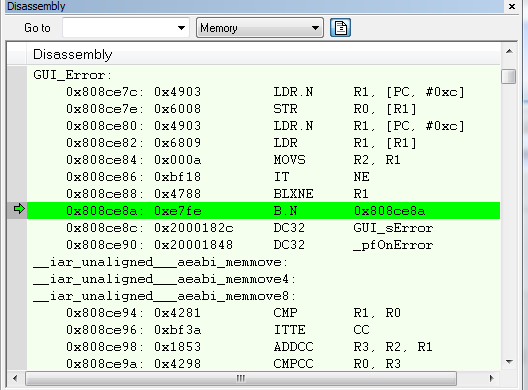

Don't know, but it looks like it's trying to generate an error, and jump to a user provided callback function to manage the error. I'd imagine that callback address is NULL, and thus not being called, and that R0 is some kind of ERROR CODE or context, which the callback could act upon.
The registers at the loop would likely be quite telling. At a guess it might be reporting it can't READ/WRITE the memory region passed, or it exceeds some limits?2013-10-17 7:48 AM
Passes through a string error message sent to
void GUI_Error(const char * s); void GUI_SetOnErrorFunc(void (* pFunc)(const char * s));http://www.segger.com/admin/uploads/productDocs/UM03001_emWin5.pdf
