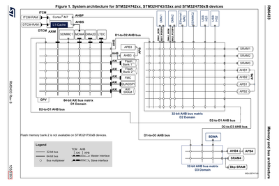

>must the transmission data buffer and reception data buffer be placed in D1 RAM?
see rm , where the different dma's connect to ->
