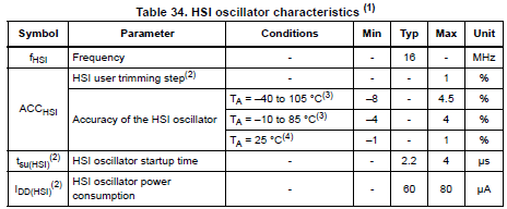

When the internal oscillator is not accurate enough for some tasks, then it's necessary to use an external crystal with tighter tolerances. Consider e.g. this one (STM32F417)
It doesn't even guarantee the +/- 5% required by asynchronous UART communication at extreme temperatures. USB requires 1.5% accuracy, so it would not work reliably if the MCU warms up a bit, that's why an external crystal is required when using USB.
That would be for Low Speed device, and no STM32 provides that AFAIK.
For Full Speed, you have to be more precise, quoting from USB2.0 7.1.11:
The full-speed data rate is nominally 12.000 Mb/s. For full-speed only functions, the required data-rate when
transmitting (T FDRATE ) is 12.000 Mb/s ± 0.25% (2,500 ppm).
