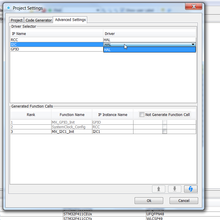

I installed this. When I go to ''settings'' it does not allow me to select LL drivers.

Hi chin.andrew,
The support of LL drivers is available for STM32CubeF4 firmware package but not yet supported in CubeMx.
Thanks
