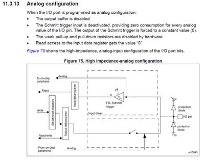

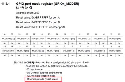

After reset it's set to Analog input and it's in high impedance state (from RM0433):
2024-12-26 11:55 PM - edited 2024-12-27 12:03 AM
After reset it's analog input:

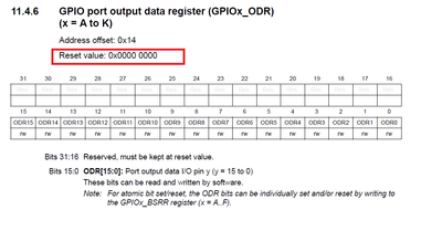

After reset the output is normally set to 0:
If you need to set it at a specific value on the initialization stage, set the value of the pin on ODR or BSRR register then configure the GPIO as output.

Thank you for your answer. I see, analog input!
Is it floating as an electric potential?
