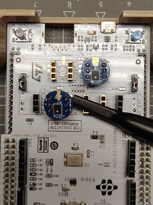

i am working on an acoustic project and starting with ST products below:
nucleo-F413zh:https://www.st.com/en/evaluation-tools/nucleo-f413zh.html
X-NUCLEO-CCA02M1:https://www.st.com/en/ecosystems/x-nucleo-cca02m1.html
STEVAL-MIC001V1:https://www.st.com/en/evaluation-tools/steval-mic001v1.html

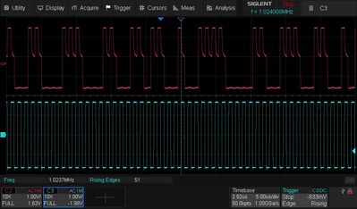

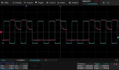

but i got different PDM waveform output
for mic1 on the left, the output is below,C2 for pdm data,C3 for clock
however,for mic2 on the right, the output is below,C2 for pdm data,C3 for clock

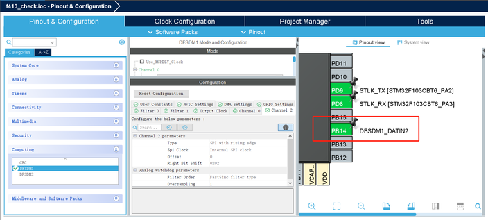

I have switched two mics, it turns out that the moment DATA pin of mems mic attached to PB14 of stm32f413zh, the waveform would turn from rectangle wave to the weird wave,
according to my configuration in cubemx,i have already set PB14 as a input channel of DFSDM1:
i have upload my cubeide project.

2025-01-05 11:40 AM
According to UM1974, red LED is connected to PB14 by default. Did you remove SB118?

2025-01-05 12:02 PM
thank you for your reply! Your advice do help me a lot!
i did forgot to remove the led on the nucleo
