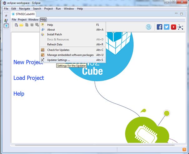

To avoid automatic updates, I advise you to follow this simple steps:
1) Click on ?Updater Settings?:

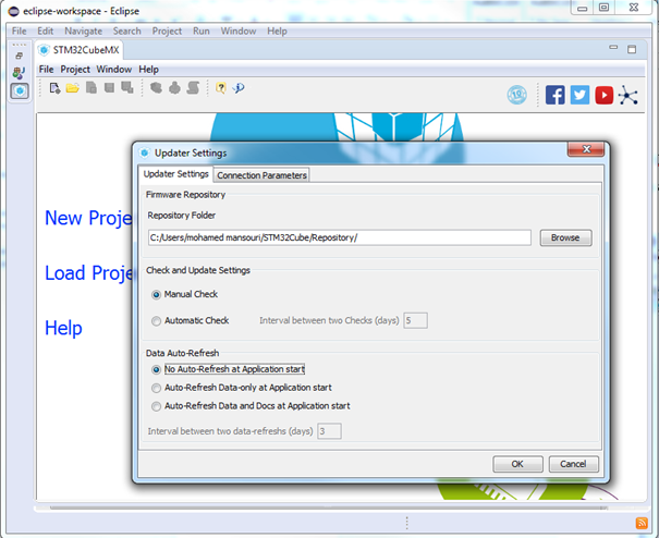

2) Then, you have to choose ?Manual check? for ? check and Update Settings? and ?No Auto-Refresh at application start? for ?Data Auto-Refresh?:

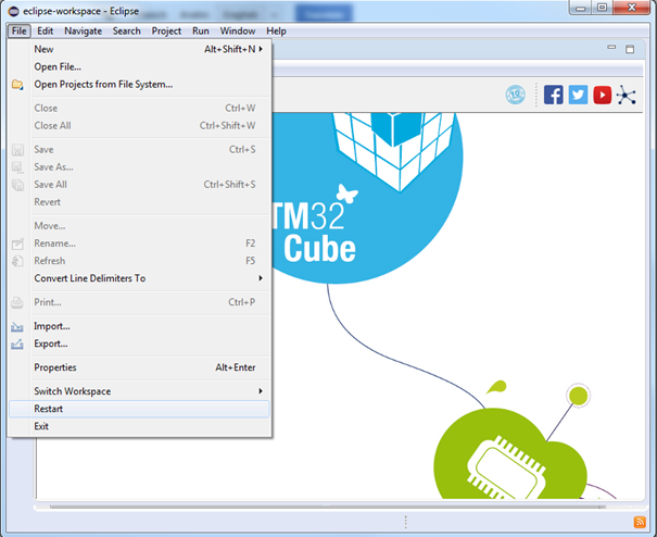

3) Finally, you should restart eclipse to validate your modification:
