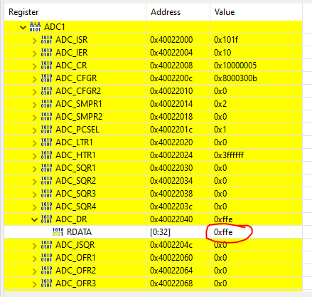

I configure the ADC1 of the STM32H735 like bellow:

}The ADC1_DR register = 0xFFE (I put 3.3V in PA0_C pin) it is ok.
but in the buffer, the dma transfer only the first byte :
I did not understand why the DMA always transfers a Byte despite I made several configuration combinations.
