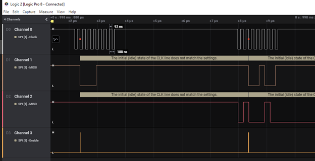

I am reading SPI from the Nucleo STM#@F401RE with the ST accelerometer LIS2DW12. I set the chip-selected pin low during the transition, but I saw the selected pin go high.
How I fix this problem?
Thanks a lot for your time,
Jack

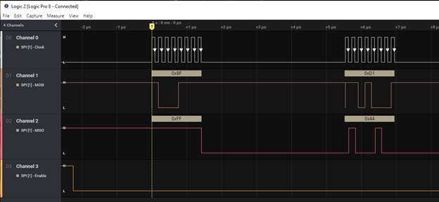

2021-06-15 2:36 PM
Hello Group,
I found my problem.
My logic analyzer ground connection is loose and that causes this problem.
I put here the correct result.
Thanks,
Jack
2021-06-14 4:56 PM
Is CS_up configured as a GPIO output pin?
Break it down to where you can toggle the pin successfully, then add in the SPI transfer.
2021-06-14 5:12 PM
Yes, set the chip-selected pin as GPIO output and control it.
During the transition, I set it low, but I see a glitch that goes high. So what is the problem causes this.
Thanks,
Jack
