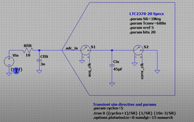

Tacq = Acquisition time. It is the time required for the Analog-to-Digital Converter (ADC) to capture the input voltage during sampling.
I am simulating this circuit basically, where it models the ADC. In the image Cin = 45pF, but in my case Cin = 5pF. Tconv = Conversion time = Tsamp + 12.5cycles. Additionally
Sampling Rate = Tacq + Tconv. In the example, they choose Sampling rate = 1MSPS, Tconv = 688ns and Tacq = 312nS.
The example is using an ADC from LTspice but in my case, I am using a STM32G0x0 MCU. So if I am sampling every 500uS, then my sampling rate is 2KSPS no? Is this possible? Because the DS shows the Maximum Tsampling is 4.56uS at fADC = 35 MHz. I am a hardware engineer, not a firmware engineer.

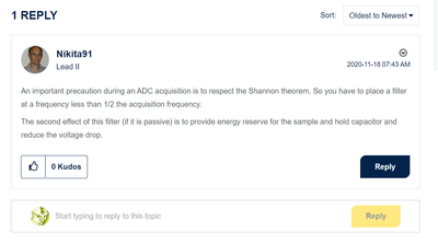

Additionally, I found that the RC filter must comply with this: https://community.st.com/t5/stm32-mcus-products/is-there-any-required-external-circuitry-for-the-adc/td-p/189255. That's why I am interested to find my Tacq.

Tacq = Tsampling / fADC
In this case, Tacq = 7.5 / 30 MHz = 250 ns.

Dear @gomezramones ,
This App Note may help you on the hardware design , especially in case of High impedance source in Section
4.4 High impedance source measurement
How to optimize the ADC accuracy in the STM32 MCUs - Application note
However I see you your External RC may be problematic with Charge transfer RC between you signal , External Cext of 3nF , Rext = 10Ohm versus our Internal requirements for good accuracy to reach such as 1/2 LSB in 10-bits.
Hope it helps you
STOne-32.
