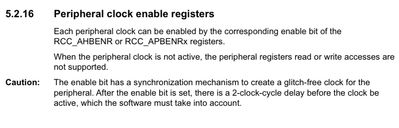

I'm new to STM32 microcontrollers, specifically STM32G070RB which is an Arm Cortex M0+ MCU.
From section 5.2.16 (page# 134) of https://www.st.com/resource/en/reference_manual/rm0454-stm32g0x0-advanced-armbased-32bit-mcus-stmicroelectronics.pdf
Peripheral clock enable registers
Caution: The enable bit has a synchronization mechanism to create a glitch-free clock for the peripheral.
After the enable bit is set, there is a 2-clock-cycle delay before the clock be active, which the software must take into account.As per https://www.st.com/resource/en/errata_sheet/dm00037591-stm32f405-407xx-and-stm32f415-417xx-device-limitations-stmicroelectronics.pdf Section 2.2.13 Delay after an RCC peripheral clock enabling, 3 workarounds are mentioned.

Dear @dtom7 ,
Welcome in STCommunity .
indeed in STM32G0 this is specified in our specification and require 2 AHB clock cycle before it will be taken into account .
my recommendation in general is just to read back the same register IOEPNR which is always valid on all cases and also if in future you would like to move to others Cores .
DSB will work as well in this case as It will take at least 1 AHB cycle and next instruction in code will follow .
