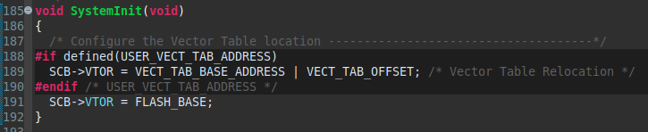

SysTick_Handler() function isn't called in a project based upon the STM32G070CB mcu (48 terminals). However, with the STM32G070RB (64 terminals (NUCLEO-G070RB)) there aren't any issues.
I found this workaround from 3 years ago (almost 4):
This post goal is to help others naive programmers like me (that trusted in ST) in case they ever face the same problem:
// system_stm32g0xx.c:
void SystemInit(void)
/* Configure the Vector Table location -------------------------------------*/
#if defined(USER_VECT_TAB_ADDRESS)
SCB->VTOR = VECT_TAB_BASE_ADDRESS | VECT_TAB_OFFSET; /* Vector Table Relocation */
#endif /* USER_VECT_TAB_ADDRESS */
SCB->VTOR = FLASH_BASE; // <---------------- WORKAROUND!

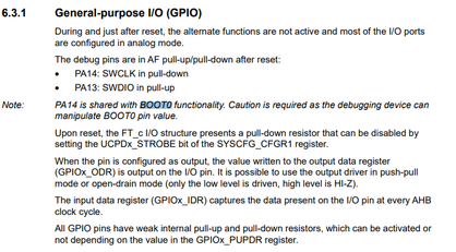

Why is the mapping wrong in the first place? Issue with BOOT0 floating or BOOTx option bytes?

2024-11-19 12:14 PM
"Why is the mapping wrong in the first place? Issue with BOOT0 floating or BOOTx option bytes?"
I have no idea. This is a fresh project ("Hello world") created completely in the CubeIDE, featuring the STM32G070CB mcu (48 terminals); the Systick interrupt just didn't trigger until I applied the workaround.
When before I created a previous HelloWorld project for the NUCLEO-G070RB (64 terminals) there weren't any issues.
2024-11-19 12:36 PM
I didn't understood the issue.
A fresh HelloWorld project created with the CubeIDE for the STM32G070CB mcu don't trigger the SysTick interrupt.
The system_stm32g0xx.c file is common to STM32G070CB and STM32G070RB (NUCLEO board).
It seems to be for me also.
Why you did suppose it's working on STM32G070RB (Nucleo) but not on STM32G070CB?
I have no idea, but applying the workaround the SysTick interrupt triggers as expected and my LED is blinking now.
According with the Eclipse IDE the code isn't active:
The USER_VECT_TAB_ADDRESS constant is neither defined for the CB nor the RB variants. However, it worked as a charm for the RB one.

For the sake of completness let me show you my schematic:
UM_6.3.1 says that SWCLK has a pull-down resistor, so I guess that, for debugging purposes, I don't need neither R100 nor R101:
