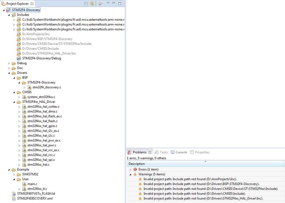

2017-04-21 4:27 AM
I tried your instructions, but it does not work. I imported example GPIO_EXTI. In pictures is the result. In work directory still missing the necessary files (
main.c file and many other files).

2017-04-21 9:01 AM
Peter,
I misunderstood your original question. I thought you were trying to copy an existing
working project in the workspace. An Eclipse issue.
The Eclipse project files are in:
STM32Cube_FW_F4_V1.15.0\Projects\STM32F413H-Discovery\Examples\GPIO\GPIO_EXTI\SW4STM32\STM32F413H_DISCOVERY
main.c is found in:
STM32Cube_FW_F4_V1.15.0\Projects\STM32F413H-Discovery\Examples\GPIO\GPIO_EXTI\Src
2017-04-24 7:07 AM
Even though I'm copying files main.c and mian.h, there are a lot of bugs there. I think the problem is in setting the right paths. But I do not know how to do it.
Could anyone write me a precise point-by-point, what should I copy and where.
I use board STM32F407-Disc1 and I need copy GPIO_EXTI from STM32Cube_FW_F4_V1.15.0 to my work directory.
