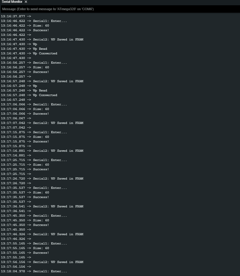

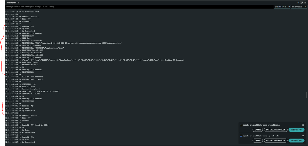

In this first image we see a post request being made by the GSM after information from the sensor arrives, but after a while it starts behaving like in the second image.
Here the information is arriving, it starts the sending procedure as shown by the Vp logs, but crashes when sending the Json information, then starts again and crashes and so on.

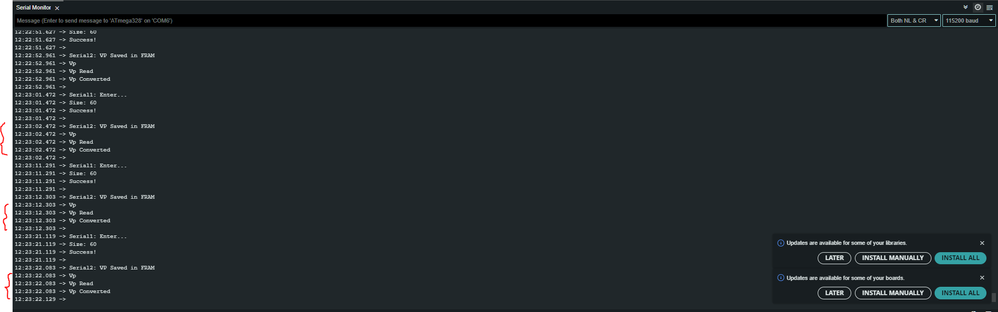

Note that the system didn't restart, but skipped the behavior of sending the json, without even sending the AT command attempt messages to the GSM.
Edit: After another period of time, he also stops his second behavior.
