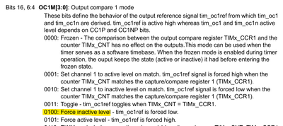

A few different ways to do this. Probably easiest is to force the value low by modifying OCxM temporarily before switching back to toggle mode.

Thank you very much, that worked, the leading signal is now always synchronised. However, it now sometimes happens that the phase shift signals are inverted in relation to each other.
I think this is due to the same problem as before. I also tried to reset them with the CCMR2 register, but that didn't work. Is there another possibility?
You're using channels 1 and 2 which are controlled with the OC1M and OC2M fields which are both in the CCMR1 register. That should work. CCMR2 controls channels 3 and 4.
